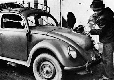

ma moze i na cvrsto gorivo (drva):
"In response to gasoline shortages, a few wartime "Holzbrenner" Beetles were fueled by wood pyrolysis gas producers under the hood"
verovatno je covek mislio da se ne moze dobiti atest na plin za vazdusare, ali eto i to moze.
